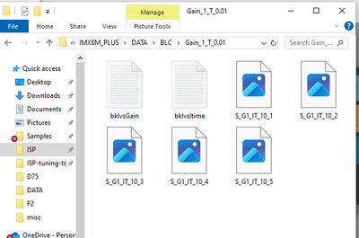

I need a clarification on Noise calibration. I have followed the steps as per the ISP Calibration Tool Suite User Guide chapter 5.1.

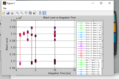

After starting calibration I was getting below mentioned chart with the value of (~5.0x10^5).
also in each folder i am getting bklvsGain.txt and bklvstime.txt.
1. In samples calibration files XML_generate/ov2775/8Mlens/01/BlackLevel/1928x1088 folder we have only one file(bls_para.txt) for final XML generate. How to get one file (bls_para.txt) from bklvsGain.txt & bklvstime.txt file which is present in each directory.
2. In samples folder bklvsltime.txt having blacklevel value as 64, but in my folder(after BLC calculation), I am getting blacklevel value as 51300. It was huge difference from the samples file. Please let me know if I am wrong here?
