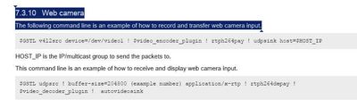

Hi Deepika
one can look at sect.7.3.10 Web camera  i.MX Linux User’s Guide​
also may be useful below
https://variwiki.com/index.php?title=DART-MX8M_GSTREAMER&release=RELEASE_ZEUS_V1.0_DART-MX8M
igor

Hi Igor,
Thanks for your valuable suggestions.
I have one doubt. Does the IP cameras enumerate into /dev/video like files?
Deepika
