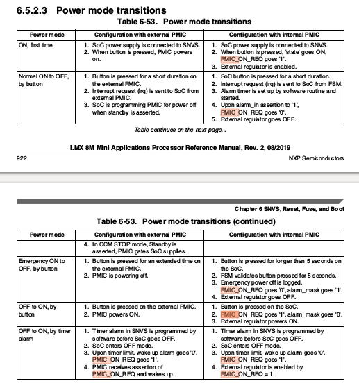

Is there any way to toggle the  PMIC_ON_REQ using software in IMX8MM

  The PMIC_ON_REQ signal can be controlled by the LPCR[TOP] and
LPCR[DP_EN] bits, say, when the 'poweroff' command is issued in Linux.
   For power on only ONOFF pin can be used.

Hello Yuri,
I have tried this method, But the PMIC_ON_REQ pin toggles only when the switch is pressed as mentioned in the data sheet.
Since I want to Control this PMIC_ON_REQ via software to reset the entire PMIC without using the switch, Is there any other way?

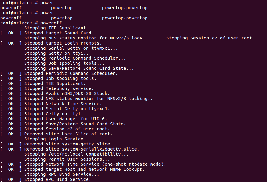

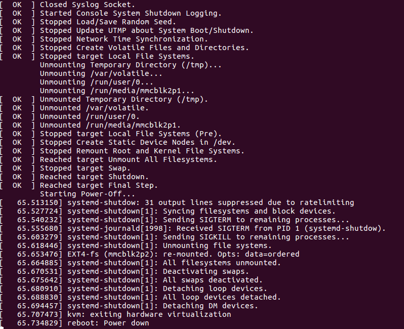

santhosh2
Power off command is available, but when poweroff command fired, the system power's off but reboot doesn't happen, Please advice any next step to try?
