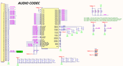

I find the PCM3168A codec, who have 6 inputs/8 outputs, I make a custom prototype with that codec, connected to J1001 connector of IMX8mm EVK (see schematic.pdf)
Based on https://bootlin.com/blog/eight-channels-audio-on-i-mx7-with-pcm3168/ I configured the device tree:

When loaded the device tree on EVK, I have:
[ 2.375321] debugfs: Directory '30010000.sai' with parent 'pcm3168a-audio' already present!
[ 2.383813] asoc-simple-card sound-pcm3168a: pcm3168a-dac <-> 30010000.sai mapping ok
[ 2.391733] asoc-simple-card sound-pcm3168a: pcm3168a-adc <-> 30010000.sai mapping ok
[ 2.399624] asoc-simple-card sound-pcm3168a: ASoC: no DMI vendor name!
[ 2.552554] ALSA device list:
[ 2.557548] #0: imx-spdif
[ 2.568080] #1: imx-audio-micfil
[ 2.571488] #2: pcm3168a-audio
[ 2.574717] #3: wm8524-audio
aplay -l
**** List of PLAYBACK Hardware Devices ****
card 0: imxspdif [imx-spdif], device 0: S/PDIF PCM snd-soc-dummy-dai-0 [S/PDIF PCM snd-soc-dummy-dai-0]
Subdevices: 1/1
Subdevice #0: subdevice #0
card 2: pcm3168aaudio [pcm3168a-audio], device 0: 30010000.sai-pcm3168a-dac pcm3168a-dac-0 []
Subdevices: 1/1
card 3: wm8524audio [wm8524-audio], device 0: 30030000.sai-wm8524-hifi wm8524-hifi-0 []
Subdevices: 1/1
arecord -l
**** List of CAPTURE Hardware Devices ****
Subdevices: 1/1
card 1: imxaudiomicfil [imx-audio-micfil], device 0: micfil hifi snd-soc-dummy-dai-0 []
Subdevices: 1/1
card 2: pcm3168aaudio [pcm3168a-audio], device 1: 30010000.sai-pcm3168a-adc pcm3168a-adc-1 []
Subdevices: 1/1
When tried to play a audio:
aplay -D hw:2,0 48000.wav    //PCM3168 don't work
Playing WAVE '48000.wav' : Signed 16 bit Little Endian, Rate 48000 Hz, Stereo
aplay: set_params:1339: Sample format S16_LE non available
Available formats:
- S24_LE
aplay -D hw:2,0 --format=S24_LE 48000.wav   //PCM3168 don't work
Warning: format is changed to S16_LE
Available formats:
- S24_LE
aplay -D hw:3,0 48000.wav  //wm8524 work
^CAborted by signal Interrupt...
When try to record
arecord -D hw:2,0 sample.wav
arecord: main:828: audio open error: No such file or directory
So, my question are:
1-Can I use the PCM3168A to have the 6 independent audios?
2-If yes, has anyone managed to configure the pcm3168 with imx8mm? Anyone can help me with the device tree configuration?
2-If not, the solution can passed to using 6 simple codecs (like wm8960 that was on many imx evk)? There are other options (but simple to implement in this micro)?
Thanks to all.
