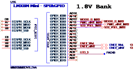

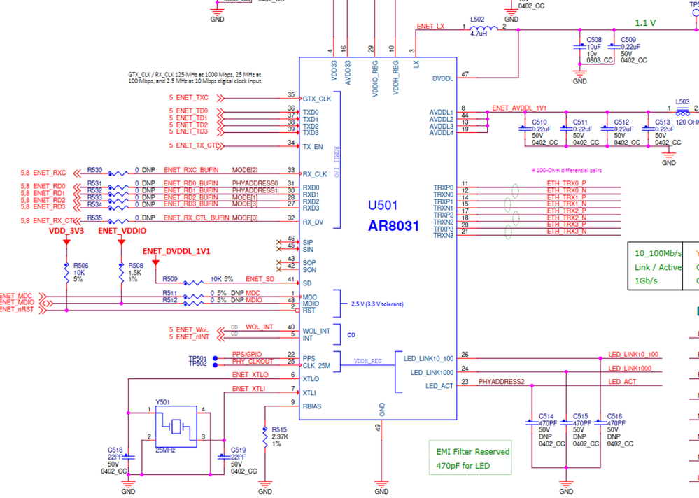

Thank you, they will try but they have some other questions:
  1. They plan to test it on our EVB, do they need to remove all of the components connected to this connector?  (U302,U303, U308) or is it enough to remove F301?
 2. USB1_OTG_ID (GPIO1_10) is connected to ENET_nINT (pin 5 of U501 – below) and I don’t see any other option for it. What can we do?
We plan to use the ETHERNET connection without the connector as well if it matters – but U501 will still be connected.

shai_b
Senior Contributor II
Hi Weidong,
Wigros Sun wrote:
Actually, these 2 USB's design can be the same as that of imx6qdl-sabreSD board. customer can also refer to iMX6QDL-SabreSD board. you konw on i.mx8mm , 2 ports are just USB2.0. their usage are the same before if they don't use USB TYPE-C.
    It's not correct, On iMX6, RGMII_INT connect to ENET_RXD1(W22), ETH_WOL_INT connect to ENET_TX_EN (V21) and    USB_OTG_ID connect to ENET_RX_ER (W23) . IMX8 EVB not include those extra pin. I need to know how to connect the below    pin on IMX8.
Right now in my customer design:
• ENET_nINT – connect to GPIO1_IO10(AD10)
• ENET_WoL - connect to GPIO1_IO11 (AC10)
• USB2_OTG_ID – Where to connect?
Can you please advise back, Thanks in advance

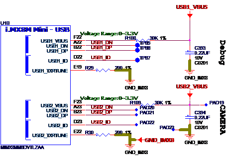

weidong_sun
Dear Shai,
See below, please!
USB2 is Power input, if you connect USB camera, you should use USB1 port.
USB2 is connected to Power adapter together with i.MX8MM-EVK kit.

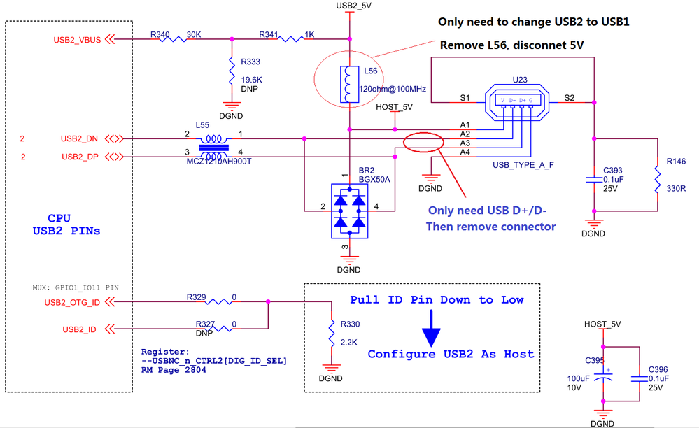

weidong_sun
Hello Shai,
  See below, please!
1. Hardware
Above schematic is for USB2,  for USB1, simiar design.
(1) Remove TYPE-A-F connector
(2) Remove L56, disconnect 5V, customer's camera doesn't need 5V
(3) connect D+/D- to USB camera module.
(4) Connect USB1_OTG_ID (not USB1_ID) to a 2.2k resistor, pulling it to LOW.
At this time, USB1 will work at HOST mode.
2. U-BOOT
Same change as https://community.nxp.com/docs/DOC-346008
--i.MX8M Mini
U-BOOT:  CONFIG_USB_TCPC=n
Device Tree:
&usbotg1 {
    status = "okay";
&usbotg2 {
    status = "okay";
Have a nice day!
