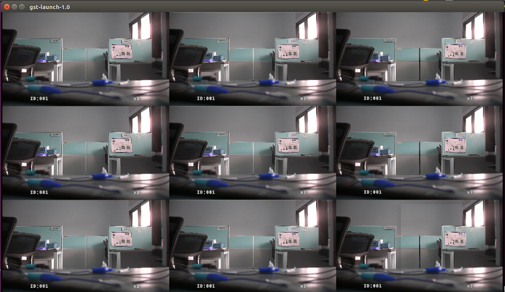

santhosh2
Thanks for the quick reply,
I have added  pixel UYVY8_1X16 in mx6s_capture.c nxp driver and i am getting the image, But same image is replicated multiple times
What is the root cause for this condition

joanxie
I dont' know how did you add this, don't forget add this format in the #define, and mx6s_capture.c already have this:
		.name		= "UYVY-16",
		.fourcc		= V4L2_PIX_FMT_UYVY,
		.pixelformat	= V4L2_PIX_FMT_UYVY,
		.mbus_code	= MEDIA_BUS_FMT_UYVY8_2X8,
		.bpp		= 2,
 maybe you need add in the "mx6s_configure_csi"

santhosh2
		.name		= "UYVY-16",
		.bpp		= 2,
This is already in the mx6s_capture.c code
Since the MIPI bridge IC that I am using support only UYVY8_1X16 and RGB888_1X24
        .name = "YUV 4:2:2 packed, CbYCrY", /*Added by santhosh */
        .mbus_code = MEDIA_BUS_FMT_UYVY8_1X16,
        .bpp = 2, /*4,*/ /*8x2=16bpp*/
       .name = "RGB888 (R-G-B-3)", /*"xBGR32",*/ /*Added by santhosh*/ /*Note: Ref TC9590XBG datasheet page 33*/
       .fourcc = V4L2_PIX_FMT_RGB24, /*V4L2_PIX_FMT_XBGR32,*/ /*https://community.nxp.com/message/1336744*/
       .pixelformat = V4L2_PIX_FMT_RGB24, /*V4L2_PIX_FMT_XBGR32,*/
       .mbus_code = MEDIA_BUS_FMT_RGB888_1X24,
       .bpp = 4,//3, /*Added by santhosh bpp=3 is tested and not to be changed for RGB888_1X24*/
But i am not able to determine why the video is multiple times produced on the screen (Screen shot attached)
1,559 Views
joanxie
how about using the command "v4l2-ctl --list-format"? I found we have imx8mm issue on UYVY and I found patch for this, maybe you can refer to them:
https://source.codeaurora.org/external/imx/linux-imx/commit/?h=imx_4.19.35_1.0.0&id=6de690dd4e78b1bf...
https://patchwork.kernel.org/project/linux-media/patch/20160902153706.512-1-niklas.soderlund+renesas...
