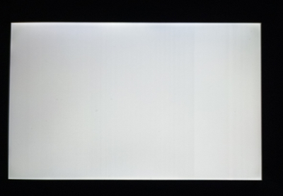

there is no proper display output on panel. not able to see the images/activities clearly.

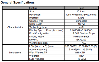

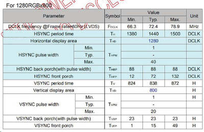

The parameters of display are as below.

                display-timings {
                        lvds {
                                clock-frequency = <72400000>;
                                hactive = <1280>;
                                vactive = <800>;
                                hback-porch = <88>;
                                hfront-porch = <72>;
                               vback-porch = <23>;
                                vfront-porch = <15>;
                                hsync-len = <80>;
                                vsync-len = <10>;

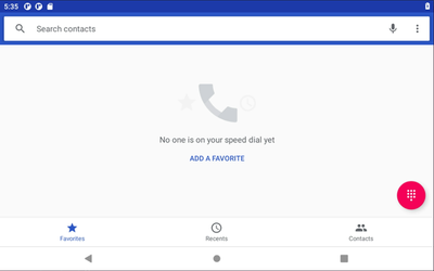

Image displayed on panel:
Expected images to be displayed:

Raghavendra
yes, now image displayed on panel is stable after fine tuning all parameters.
tested long runs at this stage.
In your case, try changing LVDS clock and observe if any change in flicker and continue to tune all blanking parameters.

I think  hsync-len should be between 1 and 40.
