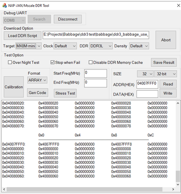

I have it down to where I am running into 1 bit being off consistently.
Manually reading the address shows everything in the 0x400800000 address doesn't get the bit set.  Please see below.

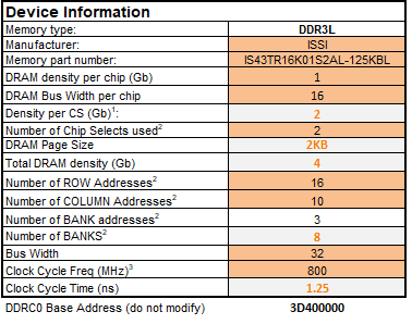

If this is tied to the memory, we are using ISSI part # IS43TR16K01S2AL-125KBL.
Datasheet for ISSI part: https://www.issi.com/WW/pdf/43-46TR16K01S2A-AL.pdf
These are the settings I am using for this part.
When I run the test I different results in Step 2: DDR memory accessing. This is a sample of one of the runs.
The address of failure can change on different runs as well as the both patterns.
