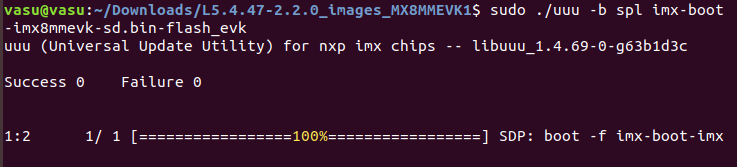

     using uuu tool trying to flash the board as flashing but it stuck in flash only.
      Our customized uboot bin file placed into uuu tool.
      1) why it stucks there only ?

AldoG
Please try running in verbose mode, you'll need to use the -v
i.e.
sudo ./uuu -v imx-boot-imx8mmevk-sd.bin-flash_evk
please share the tool output.

Dhevan
Hi @AldoG,
     Please look into attached log.
vasu@vasu:~/Downloads/L5.4.47-2.2.0_images_MX8MMEVK1$ sudo ./uuu -v imx-boot-imx8mmevk-sd.bin-flash_evk

Wait for Known USB Device Appear...
New USB Device Attached at 1:3
1:3>Start Cmd:SDP: boot -f "imx-boot-imx8mmevk-sd.bin-flash_evk"
6400%1:3>Okay (2.435s)
1:3>Start Cmd:SDP: done
1:3>Okay (0s)
Thanks & Regards,
        Vasu
