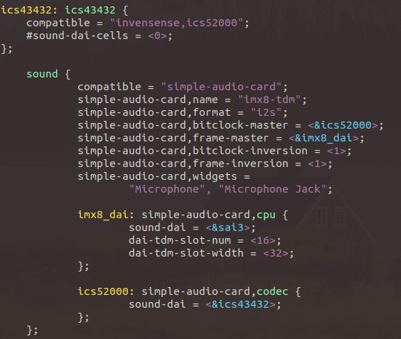

Hello everybody,
I am using the iMX8M-mini to acquire sound from 16 TDM microphones (ics52000).
I am using an external codec to drive a very low-jitter bitclock which is meant to go on both ics52000 and iMX8. However this external codec is not able to generate a frame clock based on 16 channels so I have to do this inside iMX8.
Bellow my device tree (sorry I did'nt find how to include code so I put an image)
For information my mics are working well if I generate bitclock and frame clock from internal IMX8 codec without external codec : (mode SND_SOC_DAIFMT_CBM_CFM)
   simple-audio-card,bitclock-master = <&imx8_dai>
   simple-audio-card,frame-master = <&imx8_dai>
Moreover if I try the mode SND_SOC_DAIFMT_CBM_CFS only the bitclock is generated in that mode
   simple-audio-card,frame-master = <&ics52000>
I don't know what i missed, my bitclock seems clean but it looks like the SAI don't manage to generate frameclock based on it.
For now I am trying 8kHz sample rate which gave me a 4.096MHz bitclock.
Hope you can help me on this issue.

Hi Clément
"simple-audio-card" is not supported in i.MX8 NXP BSPs, but
one can try to debug it, checking registers TCR4, RCR4, fields FSD, FRSZ,
pay attention tosect.13.9.3.3 Synchronous modes,
sect.13.9.3.4 Frame sync configuration i.MX8MM Reference Manual.
Use Chapter 7 Audio attached Linux Manual for description of sai drivers.

Hi Igor,
I found the solution to my problem. I needed the Receiver to be asynchronous. The RCR2 bit 31 tickle me.
I added fsl,asynchronous to my SAI config in the device tree
&sai3 {
   #sound-dai-cells = <0>;
    pinctrl-names = "default";
   pinctrl-0 = <&pinctrl_sai3>;
   assigned-clocks = <&clk IMX8MM_CLK_SAI3_SRC>,
   <&clk IMX8MM_CLK_SAI3_ROOT>;
   assigned-clock-parents = <&clk IMX8MM_AUDIO_PLL1_OUT>;
   assigned-clock-rates = <0>, <131072000>;
   status = "okay";
   fsl,sai-asynchronous;
Thank you for your help ,
Clément Duval

clement_duval
Thank you for your help, I checked my registers and something seems wrong. I will check this and get back to you :
TCR2 = 00000000000000000000000000000000
TCR3 = 00000000000000000000000000000000
TCR4 = 00000000000000000000000000011001
RCR2 = 01000000000000000000000000000000
RCR3 = 00000000000000000000000000000000
RCR4 = 00000000000011110001111100111001
(RCR4 bit 20 should 1 instead of 0 to have 32 bits / word)
