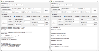

5,238 次查看
CHETHANA_RAO
Hi Igor,
In one of our design we are using MIMX8MQ6CVAHZAB and we observed that DDR stress test failing at frequencies >=1600MHz,
But even if we decrease the frequency by 1Hz,DDR stress test will pass.
(For any frequency below 1600MHz stress test will pass(viz.1599.999999MHz) but for frequencies >=1600MHz it will fail.)
Our observations goes like this.(For 1600MHz & 1599.999999MHz).
Could you please help us to resolve this.
Thanks & Regards,
Chethana
