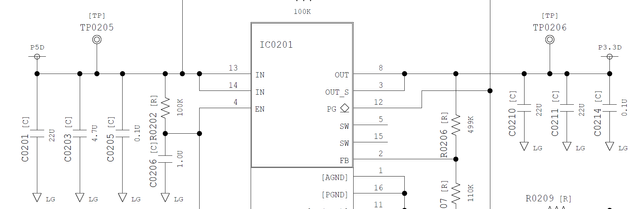

In my design, the Load Switch of the PCA9450C is not used for the power supply of the SD Card,
and one DC-DC 3.3V power supply (the reason is relatively far away) is used.

how did you connect the pins if you don't use SW? pls share the schematic, I suggest that you can use this when you use PCA9450

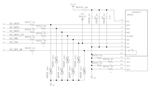

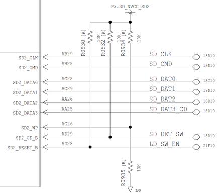

The schematic is below. In my design, SD Card‘s PS is from DCDC3.3V.
R0935,R2133,R2137 is DNP in my design.
Why  the LD must be used ?  Pls tell me, Thanks a lot.

I don't they you must use it, switch loader has overcurrent protection and short circuit protection, so we suggest that customer can use it, refer to the data sheet, if you don't use SWIN and SWout, Leave it floating if not used, and as you said you couldn't boot up from sd card when you didn't use it, what message did you get?

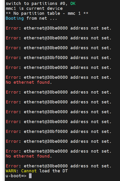

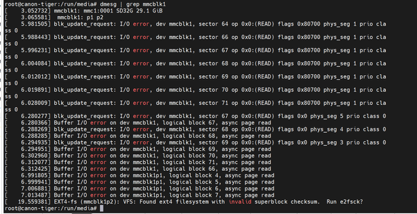

The log is as the following.Pls reference.

what do these pics stand for? the pic1 shows the board couldn't boot, but pic2 shows the board boot up successfully? could you share the whole logfile? if you don't use switch load, did you leave float SWIN and SWOUT?
