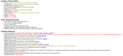

Thanks for your replies,
I think, I need to explain my problem deeper and make it more clear:
I don't have a problem with video rendering in chromium, at least not yet. Our project has already other more basic problems. Main problem is, that Canvas and Compositing is software rendered, OpenGL and WebGL is not available.
What I did:
I built the yocto image from fsl community bsp. DISTRO: fslc-x11, MACHINE: imx8mm-lpddr4-evk
I activated etnaviv and galcore. The reason, I am using X11 is, according to i.MX Yocto Project User's Guide (Rev. LF5.10.52_2.1.0 — 30 September 2021), X11 is not supported by Vivante. Building chromium ozone for wayland seems to be broken, I am always getting the error:
| Package dri was not found in the pkg-config search path.
| Perhaps you should add the directory containing `dri.pc'
| to the PKG_CONFIG_PATH environment variable
| No package 'dri' found
According to suggested workarounds, we should just add "mesa" to chromium-ozone-wayland DEPENDS, but this did not do anything. It still fails.
For xwayland, I could build chromium (chromium ozone), but the performance was veeery poor, despite the vivante drivers were used. I got about 2-4 scoring in browserbench.org.
At least, in X11 I am getting scores about 30-34.

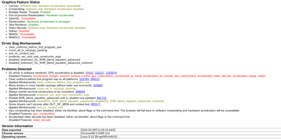

This is the output of the page chrome://gpu from this case.
Graphics Feature Status
Canvas: Software only, hardware acceleration unavailable
Compositing: Software only. Hardware acceleration disabled
Multiple Raster Threads: Enabled
Out-of-process Rasterization: Hardware accelerated
OpenGL: Unavailable
Rasterization: Hardware accelerated on all pages
Skia Renderer: Enabled
Video Decode: Software only. Hardware acceleration disabled
Vulkan: Disabled
WebGL: Unavailable
WebGL2: Unavailable

Problems Detected
GL driver is software rendered. GPU acceleration is disabled: 59302, 315217, 1155974
Disabled Features: accelerated_webgl2, android_surface_control, gpu_rasterization, accelerated_gl, metal, accelerated_2d_canvas, oop_rasterization, accelerated_video_decode, accelerated_webgl, vulkan
On kernel logs, I see etnaviv is loaded succesfully. Besides this I have no indication of properly configured/loaded/working etnaviv under Xorg.

What I did:
For xwayland, I could build chromium, but the performance was veeery poor. I got about 2-4 scoring in browserbench.org.
This is the page chrome://gpu from this case.
This the output on xterm:

arslan
Hello Kunyichen,
Thanks for your reply. I think, I need to explain my problem deeper and make it more clear:
What I did:
