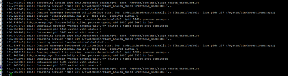

bettychen
I have the same issue on imx8mp after I disabled CONFIG_BATTERY_DUMMY in kernel.
1,504 Views
bettychen
My solution I remark  Thermal HAL in "./device/nxp/*/*/*.mk".
#PRODUCT_PACKAGES += \
# android.hardware.thermal@2.0-service.imx
