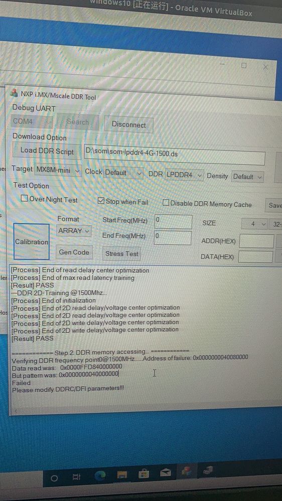

Use the mscal tool for testing, and the failure log is shown in the figure,If anyone knows how to solve this problem.

Hi @ZHUI!
For new board or memory it is necessary to follow steps described in
Chapter 4 How to bring up a new MX8MSCALE board MSCALE DDR Tool User Guide.pdf
https://community.nxp.com/t5/i-MX-Processors-Knowledge-Base/i-MX-8M-Family-DDR-Tool-Release/ta-p/110...
