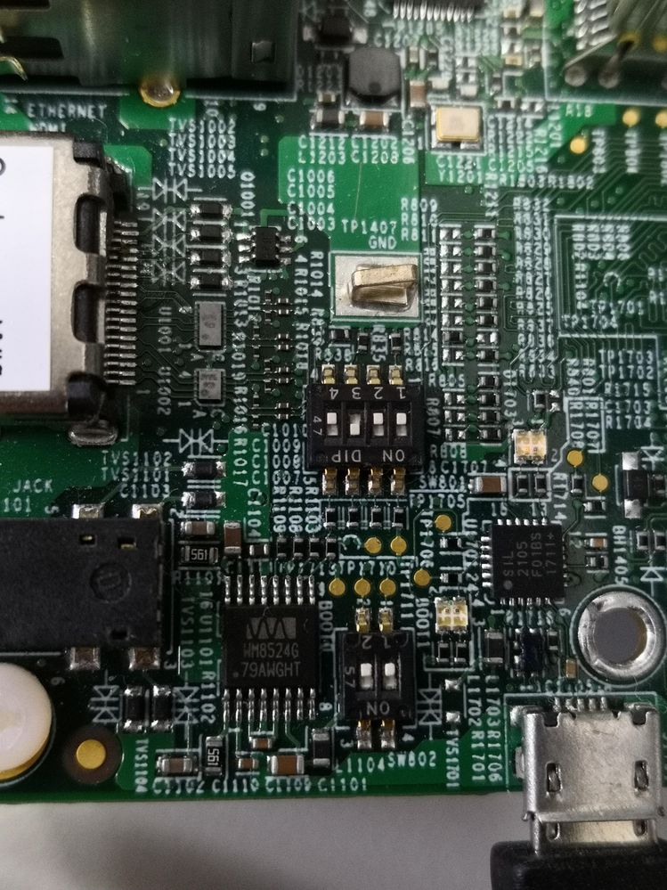

We have a I.MX8MQ EVK board,the version is B4.
It can boot to andriod system with emmc, and the debug usb-serial is well worked.
Now we want to update the system by USB serial downloader, do as the follow:
(1) Switch the bootmode of i.MX8MQ EVK SW802  BOOTMODE[1:0] from 10 to 01.
(2) Connecting J901(USB type-c) to PC USB by a USB 3.0 cable.
(3) Connecting J1701 to PC USB by a USB cable.
(4) Plugging 12V@5A adapter into Power Jack (J902)
(5) Power on I.MX8MQ board via SW701 Switch
We can see that the board is not booting from internal device, because of step 1.
But we can not use uuu or mfgtools to update the system, we have tried both on windows and Ubuntu.
Also we find there is not any HID compaliant device in the host PC.
is the TYPE-C USB serial downloader broken?
is there any methord to fix this problem?
thanks for your replay!

jimmychan
I run the L4.9.88_2.0.0_mfg-tool_MX8MQ on a new computer.
My board setting is like this:
I run the mfgtool2-yocto-mx8-evk-emmc1.vbs.
'HID' come out on the mfgtool.
4,503 Views
genggeng
I have test the I.MX8M-EVK board with the same configuration as your above picture showed.
but still can not found the HID device.
4,503 Views
