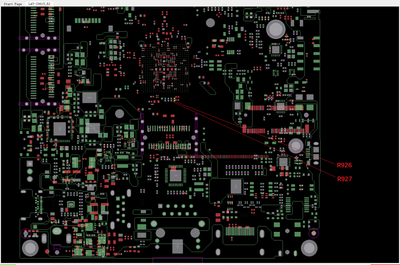

I have been trying to bringing up 88W8997-based wireless card with PCIE-USB interface. WLAN on PCIE, and BT on USB. The PCIe is detected by the board, i.e. lspci list the WiFi card. But when I do lsusb, the board does not detect the USB. I am sure the WiFi module is working perfectly on IMX6-EVK.
For a sanity check, I have tried to plug a USB stick onto USB port of the board, and it is detected. But why the USB-part of the WiFi module is not detected on its M.2 port.
Anyone have an idea? I wonder if i miss a device tree setup or kernel config.

weidong_sun
See below, please!
these 2 resistors should be removed.  R1417 and R1817 should be placed with 0 OHM .
Have a nice day!
B.R,
weidong

weidong_sun
Hello rahmanuh,
See the schematic of i.MX8M-EVK,please!
Resisters in RED circle are DNP status, DNP means Do Not Place.  So if you want to enable USB for WIFI card and SDIO card, you should populate/depopulate relevant resistors .
Try it, please!
Have a nice day!
B.R,
weidong

rahmanuh
Hi again Weidong,
I have just found R1417 and R1817. There are no resistors there, so I need to place 0 ohm resistors there, right?
But I have not found R926 and R927, could you give a hint of where are they?
Many thanks.

weidong_sun
See below, please!
Have a nice day!
B.R,
weidong

rahmanuh
Hello Weidong,
Thanks for your reply.
So in order to activate USB on M.2 port, I only need to remove both R1417 and R1418, right?
I do not need to remove R926 and R927, right?
Could you also share where is the location of the resistors on the board? I cannot open the .brd file.
