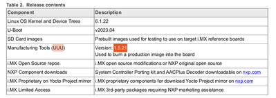

Tanushree
I reviewed the release notes for the Linux 6.1.22 kernel version and noticed that it recommends using UUU version 1.5.21. Currently, I am using the following specific UUU version as shown below:
While flashing works correctly on Windows 11 and Ubuntu 20.04 or later, it fails on Windows 10. However, I did not find any mention of supported or unsupported Windows versions in the release notes—only Ubuntu 20.04 is mentioned.
