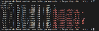

I am trying to build scfw for IMX8DXL (silicon b0)
I got the latest version (imx-scfw-porting-kit-1.13.0.tar.gz) from NXP web site.
1.
When installing scfw-porting kit, I can't find out porting kit for mx8dxl_b0
There are only mx8qx_b0 and mx8dxl_a0....
Could I use mx8qx_b0 and mx8dxl_a0 instead of mx8dxl_b0?
2.
I tried to build using scfw_export_mx8qx_b0.tar.gz...
According to guide, I installed toolchain for that (version 8-2018-q4)
When make....I encountered build error like below...
(scfw_export_mx8dxl_a0.tar.gz...have same issue too..)
Pls let me know the solution...

2. Please don't use 8qx package to build 8dxl, there is no prebuilt binaryies. Please use 8dxl a0 package.
1,564件の閲覧回数
justin_jiang
1. Please check the release note in the package,
 Support added for i.MX8DXL B0. i.MX8DXL A1 and B0 use the same code so the only source tarball is for A0.
  Also, binaries created for i.MX8DXL are run-time compatible to both silicon versions so always build with R=A0.
