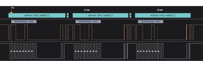

Im using IM8MM development board as slave eeprom emulator (i2c-slave-eeprom module). Im observe a long clock streching after master's request to my board. Sometimes its run normally, but usually looks like this:
I dont now why driver need 340 us stretch. I try to disable read from file in user-space and send random data from module but it stil need stretch.
 I need to speed-up this driver, because my master doesnt support that long stretch.

how can i disable clock stretching in controler? Is this even posible?

I see that you're using a SOMLABS BSP, I would suggest to contact them regarding this issue you’re seeing.
