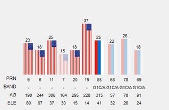

Anthony_R
Yes, this is what our different tests shows.

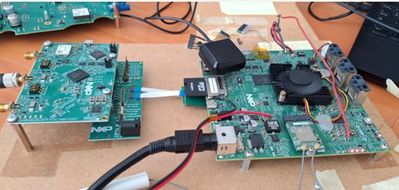

One of our test, using the EVK, is bellow.
External GPS receiver (connected to test pc) have its antenna on top of EVK.
Before applying power to EVK, GPS report the following status :

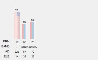

After applying power, the GPS lost its fix and most of the sats :
This test is done with  the EVK, but we have very similar behaviour with our motherboard.

In the case of your picture, I can see that you have placed your GPS antenna directly over the RJ45 Ethernet and (FTDI)USB ports. The FT2232 IC powered from the USB bus, which is not connected (so should not be problematic). The AR8031 Ethernet PHY is powered from the EVK, and runs an 25MHz crystal (which is active, even if not connected). Additionally, the RGMII interface operates at either 25 or 125MHz. With the 63rd harmonic of 25MHz at 1575MHz, this places it right inside your GPS L1 band.
You could try and disable the GMAC/Ethernet PHY from software (preferably, place the PHY in power-down), but as the Ethernet bus frequencies are standardized, the only optimization you can do is improved PCB layout and/or shielding of the noise source.
The GPS antenna placement is also right next to the dual SDIO interface towards the SAF5400 interface card, which is based on 40MHZ TCXO. The SDIO interface itself is also operating at a 40MHz clock rate (once configured from the iMX8). The 39th harmonic of 40Mhz is at 1560MHz, just outside the L1 band, but still very close (and likely in the passband of the LNA in the GPS antenna).
