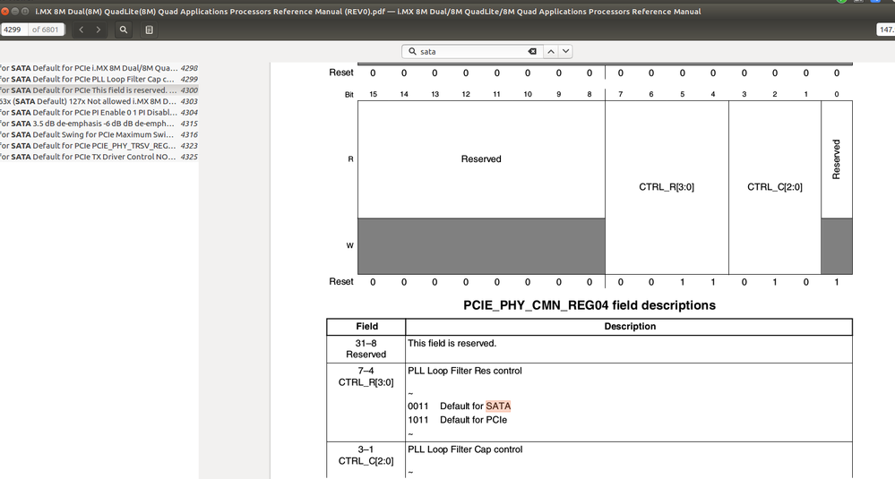

         I  have  i.MX 8M Quad Evaluation board. I  want to use  SATA SSD.  So i  conect the ssd to  M.2.
but can't  find the ssd.
         According to the Reference Manual,  it suport pci sata . but how can  i  config to  support sata. is  this have the illustrate  or  have a example  to configure.

HI,Does IMX8M support SSD?If yes, what interfaces are used?
3,650 Views
art
The i.MX8M processor does not support SATA at all. Only the PCIe interface is available.

      I  found the configuration of the sata on the imx8m chip data sheet. Is there a bug in the manual?
3,650 Views
art
Yes, this is a bug in the manual.

What I want to ask is, if you want to support pcie sata, do you need to configure the driver in the kernel?
