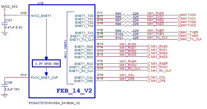

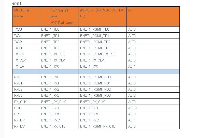

I want to configure ENET1 as MII mode;
but i have some questions
1.which pad configure as MII_TXEN
2.which pad configure as MII_RXDV
The following picture shows the PADS configuration in MII mode,is that correct?
