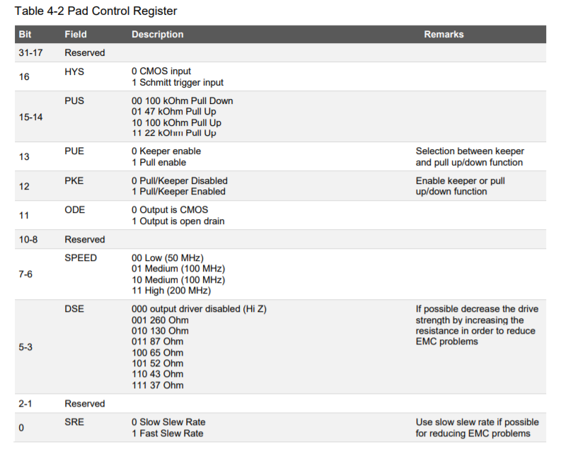

thanks we are trying to understand if the configuration of the pins is correct for our MAX98090 that is different from the wm8960 . We have set the fsl,pins in this way:

 reducing the DSE resistence and enabling the fast slew rate

with the value written in the fsl,pins (for example the 0x170A1) we are going to over-write a value of the #define here upper or what?

so had you checked signals with oscilloscope,
do they suit MAX98090 datasheet requirements ?
igor

we are trying to increase the clock signal quality changing the DSE configuration of the pins following the guide on pag 19 of this document https://docs.toradex.com/104446-colibri-arm-som-imx6ull-datasheet.pdf
