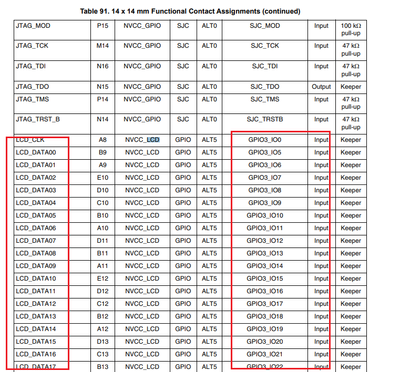

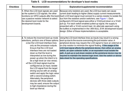

Currently, we are not using the LCD lines, and all lines are left floating, except for the following boot pins:
  • LCD_DATA_6
  • LCD_DATA_7
Could you please advise on the appropriate status we should assign to these pins if the LCD lines are not in use?

DIGITAL INPUT RECOMMENDATIONS
For unused inputs that are muxed with GPIO :
- Configure pins to be GPIO.
- Configure pins to be inputs.
- Make sure the internal pull up resistors are enabled.
For unused inputs that are not mux-ed with GPIO pins :
- Connect each pin with a 10K Ohm resistor to ground. Here the default status of LCD pins after reset are input gpio.

1. Is the hang issue caused by floating LCD pins?
2. As per the Mux table, LCD pins are multiplexed with GPIO. Should we internally pull up these pins?

Q1
-->Generally speaking this kind of strange behavior is very likely to be caused by the hardware, you need to check one by one, from the phenomenon you described, the CPU appeared to work abnormally, you should firstly check the working status of the peripheral circuits of the soc hang. Troubleshoot possible wiring problems, such as the unused pin design here.
Q2 &Q3
-->Not sure if you have deleted the default pinctrl config in dts or uboot, you need pull up the input signals internally on software and leave it floating. The input signals could affect it.
For more hardware design note, please refer datasheet and hardware design guide from here:

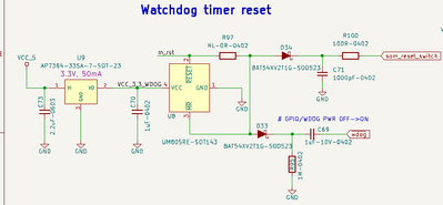

But if the kernel was hanged then any watch dog GPIO will give output (low/High pin)? like intimate me through watch dog GPIO. we have external Watchdog reset section in our design which is resetting our system after hang. below is image for reference.
-->All of this presupposes that the kernel-based watchdog driver can be triggered properly, and from what you've described, it seems that there's something wrong on the hardware side that's preventing the kernel from running properly and thus triggering the watchdog driver.
