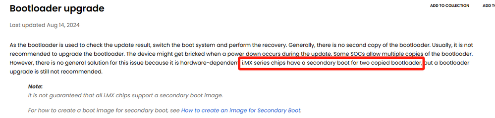

3.One of the risks of this solution is that when the U disk boots the system to burn Uboot to NAND, the device loses power, resulting in the NAND Uboot burning not being completed, which will cause the device to fail to run Uboot in NAND, and the device cannot boot and boot to the U disk again for burning.
4.Update whether there are other solutions for Uboot in the device, which can ensure that during the burning process, especially in the process of re-burning uboot, the sudden power failure can also ensure that the device can be started normally or can be burned again, instead of the device becoming a brick.
5.Can IMX6ULL run the backup partition uboot if there is a problem with the primary partition uboot by using BootRom to divide the two-zone uboot in NAND?

Our product has the need to update Uboot, in order to ensure that updating Uboot is also safe, there will be no abnormal equipment such as power failure when updating Uboot, resulting in bricks of the device, I see that IMX6ULL have a secondary boot for two copied bootloader, I asked for advice on how to do Uboot double backup on NAND flash?
