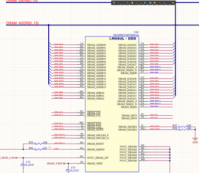

i am designing iMX6ULL with 2slot 512Mbx8. Can the NXP team help me with the schematic?

Hi @duyhai,
I hope you are doing well.
Please share the schematic pdf for review since the image is not properly visible.

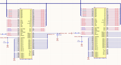

duyhai
this is my design

riteshmpatel
Hi @duyhai,
The DDR3L schematic section seems okay.
