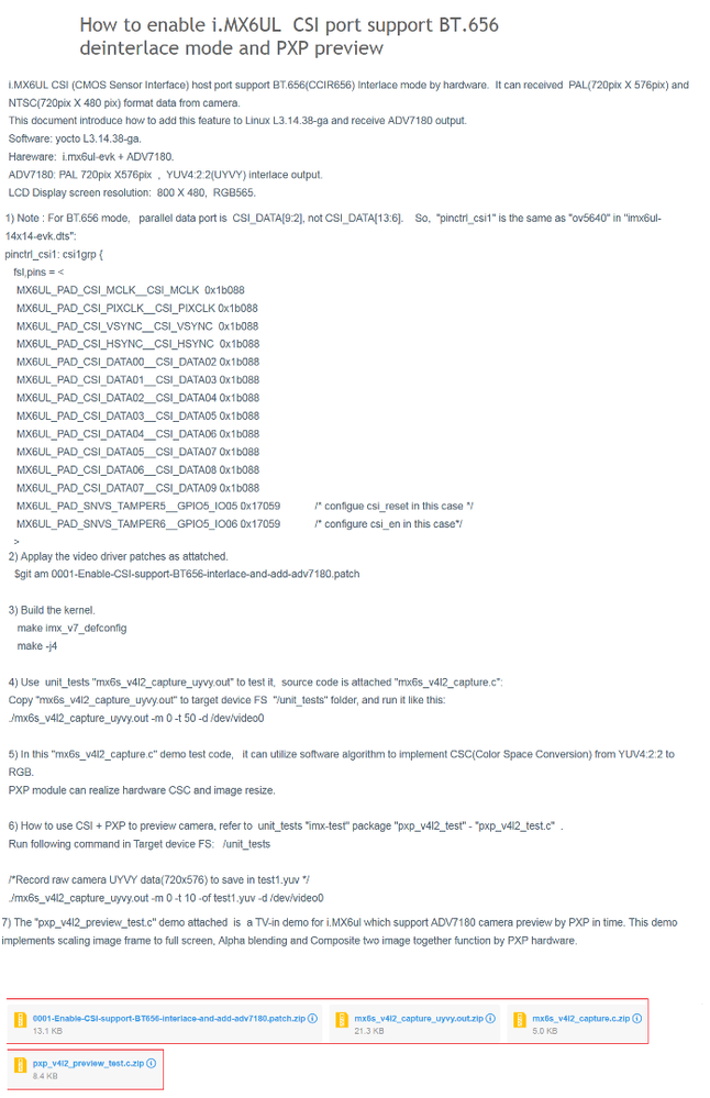

ou can reference to followed patch, the CSI module and driver are same for iMX6ULL and IMX6UL, and PAL is more easy than NTSC to support:  https://community.nxp.com/docs/DOC-330092
   Document on the link is what I had sent to you before. this is our internal link, probably you couldn't access it. so I had to copy it and send to you.
   After you patch it to your kernel, you can run images, then you will see all configurations for BT.656.
Have a nice day!

weidong_sun
Hello rickman,
   See below, please!
If you don't have files in attachments, you can  submit a case to me via our salesforce system, I will send them to you by email!
You can follow below steps to submit your case:
1. open the link
https://www.nxp.com/support/support:SUPPORTHOME
2.In the middle of web page, under "Support Requests",Press "Go to Tickets"。
3.Log in;or register a new account,log in personal emal to validate information。
4.Log in web via account,Press "Add a folder"
5.after success, Add a new case? to submit a new question
weidong sun
