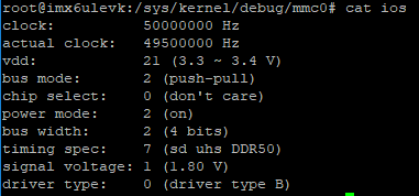

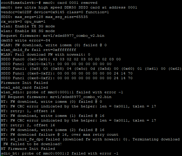

I am playing with the imx6ulevk and want to make a wifi/bluetooth combo module PAN9026 works on it by building a yocto image. The module uses sdio to communicate and the final built system can recognize the module but failed to download the binary FW through sdio as follow.
I am very confused about the error: cmd53 write error=-84, cannot find any detail about this error online.

I think this driver is successfully installed.
and also sure the firmware requested in the system exist.
mmc0 also looks fine
system info

For anyone who has the same problem, I fixed mine by resetting the PAN9026 using the PDn pin. Cycle it low, then high. Solution taken from PAN9026 initialization problem after reboot - Non-Embedded Multi-Mode - Panasonic Technical Forum .

possible i.MX6UL cmd53 errors and workarounds are described in
sect.56.4.1.4 Dividing Large Data Transfer i.MX6UL Reference Manual,
also one can try to ask updated firmware for L4.9.88 kernel from PAN9026
vendor tech support.
