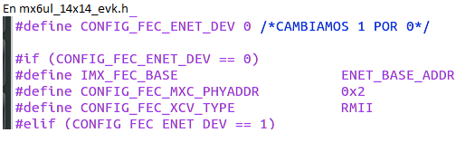

Hi everybody,
My partner Goiatz Leibar and me are facing this issue.
First of all, say we have a customized board with the IMX6UL processor. and with the kernel 3.14.38-6UL
The fact is that we got ethernet working in u-boot but not in kernel.

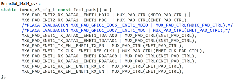

We use ENET1 and as we also use the GPIO1_IO06 and GPIO1_IO07 for other purposses, the MDIO and MDC are in "ENET2_RX_DATA0 and ENET2_RX_DATA1"
In U-BOOT (working fine)
This are the chages so ethernet works in u-boot.
We select FEC 0, (mx6ul_14x14_evk.h)
We change the MDIO and MDC pins (mx6ul_14x14_evk.c)

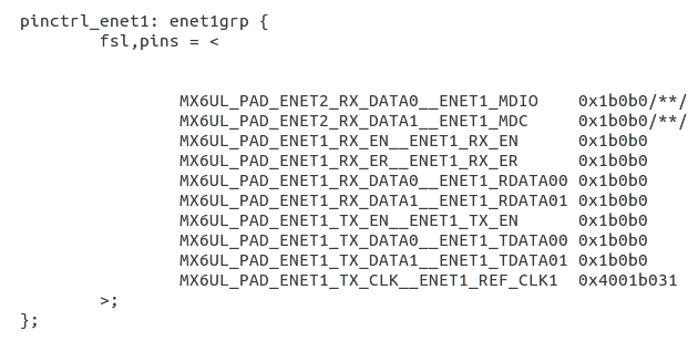

In Kernel
But when we try to make it works in kernel, we do the following with no succsses

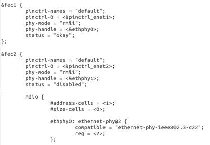

In kernel's device tree (imx6ul14x14-evk.dts):
We disable FEC2 and we also add our board pins

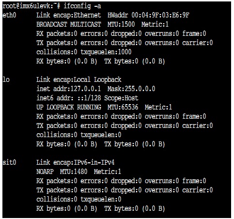

Once the system has booted, we make an "ifconfig -a" and here you can see how MAC address is the one we asigned before in u-boot.
Please find attached the .log file when the board boots

Hello Alberto Lubeiro ,
If you disable FEC2, you need to add mdio to FEC1, like this:
&fec1 {
               pinctrl-names = "default";
               pinctrl-0 = <&pinctrl_enet1>;
               phy-mode = "rmii";
               phy-handle = <&ethphy0>;
               status = "okay";
               mdio {
                              #address-cells = <1>;
                              #size-cells = <0>;
                              ethphy0: ethernet-phy@2 {
                                             compatible = "ethernet-phy-ieee802.3-c22";
                                             reg = <2>;
                              ethphy1: ethernet-phy@1 {
                                             reg = <1>;
&fec2 {
               pinctrl-0 = <&pinctrl_enet2>;
               phy-mode = "rmii";
               phy-handle = <&ethphy1>;
               status = "disabled";
And this change in the FEC1 pins:
                              pinctrl_enet1: enet1grp {
                                             fsl,pins = <
                                                            MX6UL_PAD_ENET1_RX_EN__ENET1_RX_EN       0x1b0b0
                                                            MX6UL_PAD_ENET1_RX_ER__ENET1_RX_ER        0x1b0b0
                                                            MX6UL_PAD_ENET1_RX_DATA0__ENET1_RDATA00               0x1b0b0
                                                            MX6UL_PAD_ENET1_RX_DATA1__ENET1_RDATA01               0x1b0b0
                                                            MX6UL_PAD_ENET1_TX_EN__ENET1_TX_EN        0x1b0b0
                                                            MX6UL_PAD_ENET1_TX_DATA0__ENET1_TDATA00               0x1b0b0
                                                            MX6UL_PAD_ENET1_TX_DATA1__ENET1_TDATA01               0x1b0b0
                                                            MX6UL_PAD_ENET1_TX_CLK__ENET1_REF_CLK1 0x4001b031
                                                            MX6UL_PAD_GPIO1_IO06__ENET1_MDIO           0x1b0b0
                                                            MX6UL_PAD_GPIO1_IO07__ENET1_MDC                            0x1b0b0
These changes disable FEC2 in EVK and FEC1 works.

alubeiro
Hi Luis,
Thanks! we have just added it and it works!
Thanks again and best regards.
