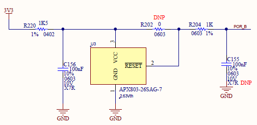

Please find attached also our scheme "Esquema USB.jpg" the things inside red circles are DNP

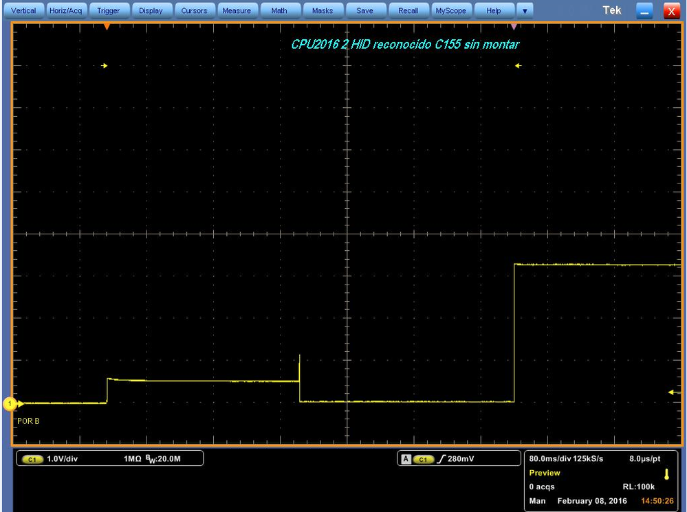

1,879 Views
alubeiro
Hi all,
Finally we get it, we have removed a 100nf capacitor (C155) which was in the POR_B line.
I don't belive it is the only thing wrong because we have another board without this capacitor and it isn't detected as an HID unit.
The POR_B pin has an internal 100K pull-up which made a rising edge more light (in case of mounting C155) due to RC = 10 ms, but in anyways i don't undertand why may be this cause of the problem, unless there is a minimun rising edge time, but i don't see anything in datasheet refering to this.
Thanks and best regards

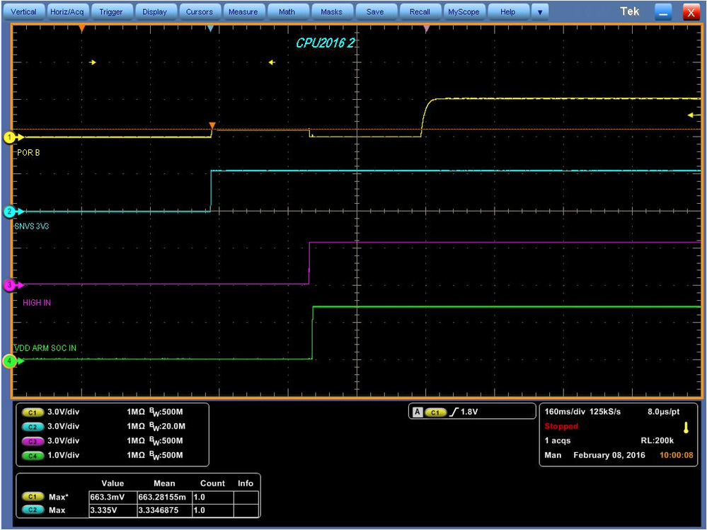

LuisCasado
Hi Alberto,
Have you checked this point from HW design guide?
Luis
1,879 Views
alubeiro
Hi Luis,
Yes, we have checked it out and here you can see the power on secuence in both cases, C155 placed and not placed.
The secuence is right. The only diference is the time of the last rising edge.
I didn't save the picture but i did another one, same as the "CPU2016 HID reconocido C155 sin montar" but with C155 placed and i overlayed it in order to see the diferences, and the only diference was the rising up time. This is the reason i don't understand why it doesn't work unless there is a rising up time requirement. ¿is there?
Thanks and best regards.
