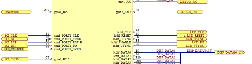

My company is planning to implement cardreader using SIM1 PORT1 of IMX6ul interfacing to TDA8035.
When I ran mxc_sim_test.out to test sim functionality, It is giving me following output.
atr[0]= 0x0
Receiving timeout
Error when tx/rx:-1
do you all have any idea,What can be wrong?
For more information, here is our implementation.
Pin configuration as shown in schematic here.
IMX6UL pin settings
I have couple of questions, Have I implemented device tree shown below correctly, according to schematic?

As we want to select 5v, I have asserted gpio high as (pinctrl-assert-gpios = <&gpio2 16 GPIO_ACTIVE_HIGH>;) and EN_1.8V as high through IO Expander.
2. Is the above dts setting for asserting gpio2 16 pin is correct?
This is urgent, Could someone help please?

Scenario How I am testing:
Sim1 Port1 is connected to TDA8035:
First scenario
I am inserting Smart Card into into Card reader module and running mxc_sim_test.out. Ouput is:
No cardsim_cold_reset
NO card ...
Second scenario
I am not inserting Smart Card into into Card reader module and running mxc_sim_test.out. Ouput is:
Receiving timeout
Error when tx/rx:-1
3,268 Views
igorpadykov
Hi Asma
one can check with oscilloscope if there any sim signals.
igor
