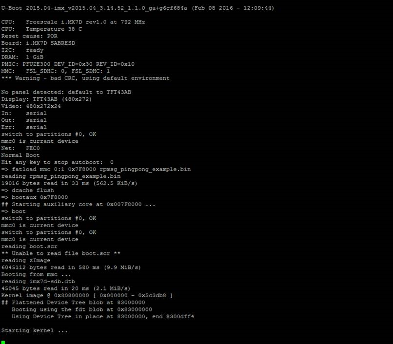

chandiniindavar
Hi Alan,
even i have same problem kernel locks after loading m4 when i try to boot
I am using IMX7D board
have imx7d-sdb.dts file .. where exactly i have to copy ..i copied to my board SDCARD but still same response .
Could you please tell me where i have to copy
Thanks in advance
2,508件の閲覧回数
chandiniindavar
problem solved by doing this:
$ setenv fdt_file imx7d-sdb-m4.dtb
$ save

mirkoardinghi1
Thanks, it works!
