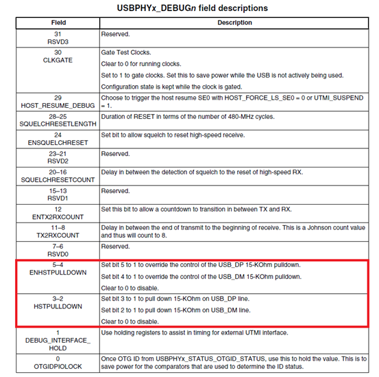

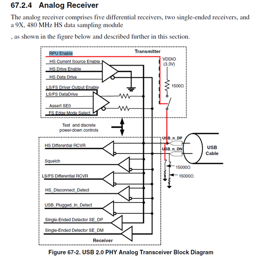

I'm using USBOTG2 in peripheral mode. After loading the USB gadget serial driver(g_serial.ko), the D+ line is automatically pulled HIGH, even though it is not connected to a host yet. However, I don't want the D+ line to be pulled up if it's not connected to the host. Is it possible to control this D+ line?
I found the following information online. Is this "firmware control" supported by IMX6SX? Thanks.

jimmychan
According to the Reference Manual 67.2.5.4 Switchable 1.5KΩ USB_DP Pullup Resistor
This product contains a switchable 1.5 KΩ pullup resistor on the USB_n_DP signal. This resistor is switched on to indicate to the host/hub controller that a full-speed-capable device is on the USB cable, powered on, and ready. This resistor is switched off at power-on reset so the host does not recognize a USB device until the processor software enables the announcement of a full-speed device.
However, we do not recommend that you manually change this configuration, because the USB driver will control it.
