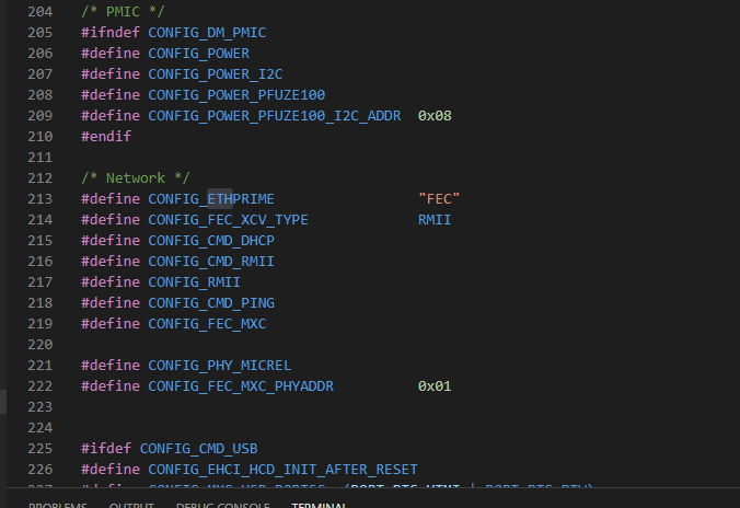

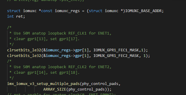

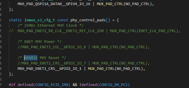

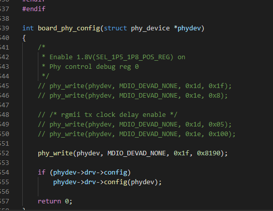

I am using the IMX6SX chip with 800M frequency and yocto to build the file. The uboot version number is 2020.04-5.4.24-2.1.0. Because we don't need a gigabit network, the AR8031 network chip is replaced with a KSZ8081 chip, using the RMII interface. But no matter how I modify the two files git/board/freescale/mx6sxsabresd/mx6sxsabresd.c and git/include/configs/mx6sxsabresd.h, they have no effect. What should I do to make KSZ8081 work properly? In addition, we use an external crystal oscillator as the clock source.QQ截图20210118182741.pngQQ截图20210118182924.pngQQ截图20210118182937.pngQQ截图20210118183001.pngQQ截图20210118183024.png

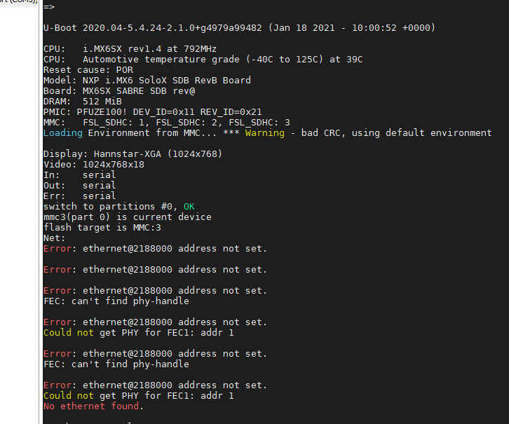

I found that the network used the device tree and entered the function fecmxc_probe. I want to ask if this function initializes the RMII/RGMII interface? How can I modify this file and the device tree file to achieve my function?

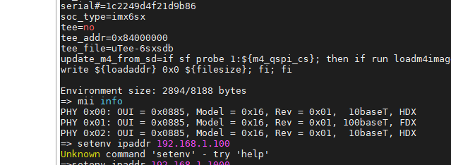

Thank you very much for your reply. Now my board can communicate with ksz8081, but the network is unavailable. I guess it is related to changing RGMII to RMII and providing clock source through external crystal oscillator, but I am not sure how to modify this.QQ截图20210122131529.png
1,827件の閲覧回数
joanxie
could you share your uboot environment with me? by command "printenv"
