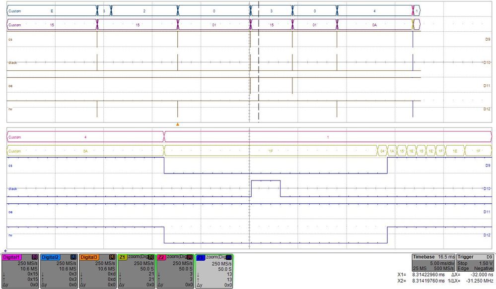

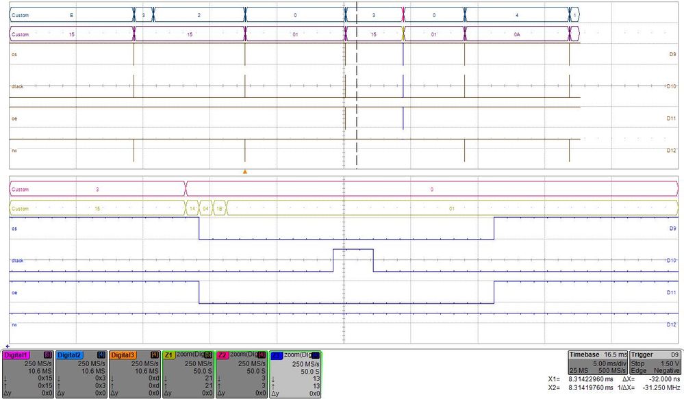

I measured the different signal on the WEIM bus. Sometimes it works perfectly and sometimes the system hangs. However the signal and timing looks good before the hang.
IMX6QP read:
IMX6QP write:
IMX6QP hang:
I also performed the measure on the imx25 and the signals look the same.
IMX25 read:
I'm not sure it is possible to read the orange signal name so from top to bottom : CS, DTACK, OE, RW
Thanks for your help
