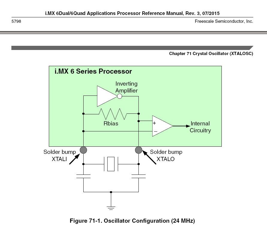

igorpadykov
Hi Ali
24MHz produces clocks for processor core and all other
peripherals, please check CCM chapter of Reference Manual.
Without it processor will not boot.
igor
4,117 Views

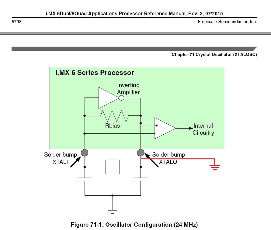

alielseddeek
Thanks Igor for your reply,
To be more specific, I had a schematics' mistake in my board which lead that XTALO pin of the IMX6Q is connected to the ground in an intermediate layer of my board, so it is nearly impossible to fix it without manufacturing a new board with the corrected schematics.
My question is:
Is there any method that could override this crystal (24 MHZ) or XTALO by using any other crystal or pin to power up my IMX6Q?
or I should re-manufacture my board to power my IMX6Q?
Thanks in advance
Ali Elseddeek

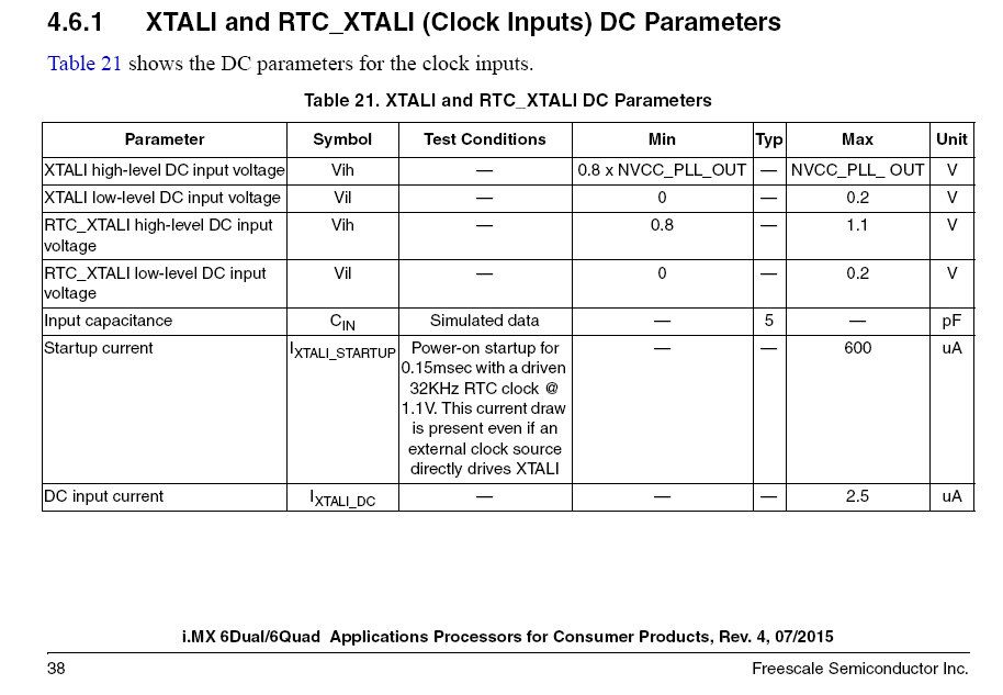

4,117 Views
igorpadykov
Hi Ali
one can apply external clock to XTALI
use Table 21. XTALI and RTC_XTALI DC Parameters
i.MX6DQ Datasheet
http://cache.freescale.com/files/32bit/doc/data_sheet/IMX6DQCEC.pdf
igor

alielseddeek
Thanks Igor for your reply but I think that I was not clear enough in my question last time.
To be more clear I had the external 24 MHZ oscillator connected to my IMX6Q as shown in the image while the XTALO pin grounded and it couldn't be removed unless I re-spin the board.
My questions are the following:
Q1) I searched for "Table 21. XTALI and RTC_XTALI DC Parameters" you mentioned but I couldn't find it, could you be more specific about where I could find it, please?
Q2) Could I power up the board with the XTALO pin grounded as in the image by any other modification you suggest?
Q3) Is it possible to power up the IMX6Q by entering the needed voltages by power supplies MANUALLY?
Thanks in advance
Ali Elseddeek
