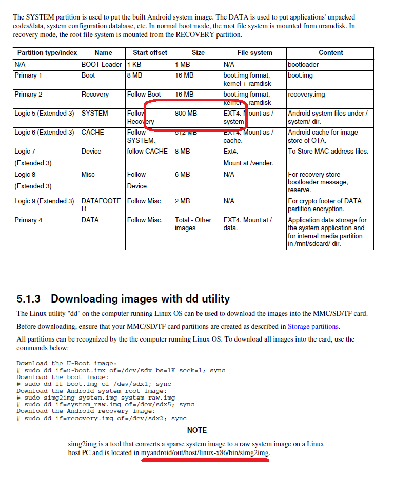

I have IMX6Q SABRE SDB bouard.
I am using pre-build android image to get display on HDMI interface. (android_KK4.4.3_2.0.0-ga_core_source ).
When I start booting,  I got the below debug prints

I could see only ANDROID name on the HDMI Display after it's not showing anything.
Any suggestions please.

init: cannot find '/system/bin/servicemanager', disabling 'servicemanager'
init: cannot find '/system/bin/vold', disabling 'vold'
init: cannot find '/system/bin/netd', disabling 'netd'
init: cannot find '/system/bin/debuggerd', disabling 'debuggerd'
init: cannot find '/system/bin/surfaceflinger', disabling 'surfaceflinger'
init: cannot find '/system/bin/app_process', disabling 'zygote'
init: cannot find '/system/bin/drmserver', disabling 'drm'
init: cannot find '/system/bin/mediaserver', disabling 'media'
these means system image is not flashed correctly.

Have you  used mfg tool to try?
and the partition layout in Android is differenct now.
In Android 6.0, the system partition is about 800M.
In Android 6.0, the system.img need simg2img to convert.
If you didn't use mfg tool, did you use the "simg2img" to convert the image?

Hi BiyongSUN​,
I'm actually wondering why the documentation says 800MB whereas the source code sets it to 600MB? (see device/fsl/imx6/BoardConfigCommon.mk line 84). Also the commit says it changes the sparse image size but BOARD_SYSTEMIMAGE_PARTITION_SIZE changes the raw image size, not the sparse one.
Finally, the flashing script provided in the device folder (device/fsl/common/tools/fsl-sdcard-partition.sh) as well as the script provided in the MFG tool still sets the system partition to 512MB which seems very unlikely to work.
Please clarify.
Gary

Here is the souce code of Android 6.0
android-m6.0.1-1.0.0-ga/device/fsl/imx6/BoardConfigCommon.mk
78 # comment out for 1g/3g space split
79 # TARGET_KERNEL_2G := true
80
81 BOARD_BOOTIMAGE_PARTITION_SIZE := 16777216
82 BOARD_RECOVERYIMAGE_PARTITION_SIZE := 16777216
83
84 BOARD_SYSTEMIMAGE_PARTITION_SIZE := 629145600
85 BOARD_CACHEIMAGE_PARTITION_SIZE := 444596224
86 BOARD_FLASH_BLOCK_SIZE := 4096
87 TARGET_RECOVERY_UI_LIB := librecovery_ui_imx
88
89 # Freescale multimedia parser related prop setting
If you have checked the mksdcard-android.sh in android_m6.0.1_1.0.0_ga_tool\Profiles\Linux\OS Firmware\mksdcard-android.sh.tar
you will see SYSTEM_ROM_SIZE=800.
So far, in the Android 6.0, the system.img is about 526M.
after using simg2img, it is about 629M.
That is mininal size needed, so leave more space set the patition to 800M.
526867648 Mar 14 15:59 system.img
629108736 May 25 16:32 system_raw.img
#!/bin/bash
# partition size in MB
BOOTLOAD_RESERVE=8
BOOT_ROM_SIZE=16
SYSTEM_ROM_SIZE=800
CACHE_SIZE=512
RECOVERY_ROM_SIZE=16
DEVICE_SIZE=8
MISC_SIZE=6
DATAFOOTER_SIZE=2
help() {
bn=`basename $0`
cat << EOF
usage $bn <option> device_node
options:
  -h    displays this help message
  -s    only get partition size

Sorry I must have downloaded the wrong MFG tool package, re-downloaded this one today and it is indeed 800MB.
IMX6_M6.0.1_1.0.0_MFG_TOOL
However the script in the source code is wrong, please update it for next release (device/fsl/common/tools/fsl-sdcard-partition.sh).
Gary
