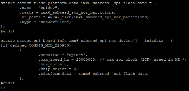

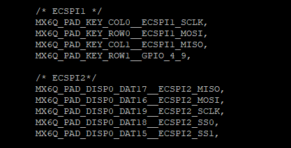

I have a few questions about SPI.
I am developing using the imx6q-sabresd board.
Here is my code :
1. fsl-community-bsp/build/tmp/work/imx6qsabresd-poky-linux-gnueabi/linux-imx/3.0.35-r37.14/git/arch/arm/mach-mx6/board-mx6q_sabresd.h
/* ECSPI1 */ is the existing code and I added /*ECSPI2*/.
2. fsl-community-bsp/build/tmp/work/imx6qsabresd-poky-linux-gnueabi/linux-imx/3.0.35-r37.14/git/arch/arm/mach-mx6/board-mx6q_sabresd.c
3. add CONFIG_SPI_SPIDEV=y
I made this setting, but I can not see the / dev / spi related device.
I need help. please.
CHEON

igorpadykov
Hi kangta
one can look at L3.0.35 spidev example:
/dev/spidev not appearing on iMX6Q despite kernel configuration and modalias="spidev"
igor

igorpadykov
could you try linux from
linux-2.6-imx.git - Freescale i.MX Linux Tree
igor
3,802 Views
ktc7270
Thank you for your help. Now I can see /dev/spi2.0.
