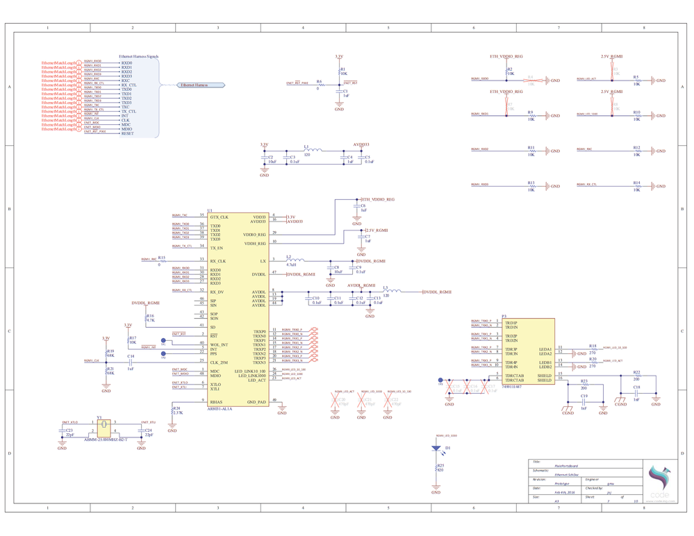

We are facing a problem getting the AR8031 phy to work in a custom imx6 board. The issue is that we can’t get a manual IP address and we also can’t get an IP address from the DHCP server.

Part of the schematic:
What could be the reason for this problem?

Check the ENET_REF_CLK pin of MX6Q is toggled or not.
2,054 Views
jimmychan
In the PHY reset, you set to '0' again after the delay.
Please set to 1 after the delay.
gpio_set_value(ETH_PHY_RESET, 1);
Because the PHY reset GPIO pin is using the SD2_DAT. If still not work, please double check the SD2_DAT2 has been used in other place or not.
