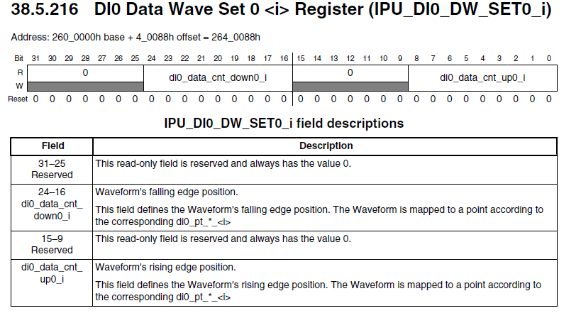

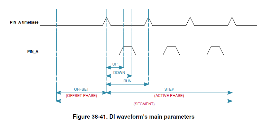

COUNTER_2 means the signals on DI_PIN2, and COUNTER_3 means the signals on DI_PIN3.
The COUNT UP, COUNT DOWN, offset can be used to adjust the HSYNC/VSYNC position and width, but you also need check the register bit width, there is limitation for such use case.

qiang_li-mpu_se
@@ -3123,11 +3123,11 @@ int32_t ipu_init_sync_panel(struct ipu_soc *ipu, int disp, uint32_t pixel_clk,
      DI_SYNC_NONE,  /* offset resolution */
      0,   /* repeat count */
      DI_SYNC_NONE,  /* CNT_CLR_SEL */
-     0,   /* CNT_POLARITY_GEN_EN */
+     1,   /* CNT_POLARITY_GEN_EN */
      DI_SYNC_NONE,  /* CNT_POLARITY_CLR_SEL */
-     DI_SYNC_NONE,  /* CNT_POLARITY_TRIGGER_SEL */
+     DI_BT656_SYNC_BASECLK,  /* CNT_POLARITY_TRIGGER_SEL */
      0,   /* COUNT UP */
-     0  /* COUNT DOWN */
+     2*80  /* COUNT DOWN */
    vsync_cnt = DI_BT656_SYNC_IVSYNC;
@@ -3142,11 +3142,11 @@ int32_t ipu_init_sync_panel(struct ipu_soc *ipu, int disp, uint32_t pixel_clk,
+     DI_BT656_SYNC_HSYNC,  /* CNT_POLARITY_TRIGGER_SEL */
      0,   /* COUNT UP */
+     2*10  /* COUNT DOWN */
    /* COUNTER_5: first active line */
6,273 Views

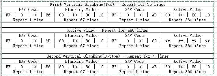

An example for 720*480P
+ /* NTSC Progressive output */
+ "BT656-480P", 60, 720, 480, 18518,
+ 36, 9,
+ 0, 0,
+ 276, 1,
+ FB_SYNC_HOR_HIGH_ACT | FB_SYNC_VERT_HIGH_ACT,
+ FB_VMODE_NONINTERLACED,
+ FB_MODE_IS_DETAILED,},
That means the frame is followed, 276 = (1+67+1) * 4:
For the HSYNC/VSYNC adjusting, please read the discussion in https://community.nxp.com/docs/DOC-94019.

qiang_li-mpu_se
