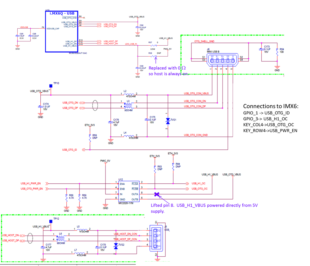

I have two usb ports, a usb-standard A port and a usb-mini port, on my custom board, neither of which are working properly.  My custom board has an IMX6Q and is based on the sabresd platform.
When I plug a usb stick into the usb-standard port I get the following output on dmesg:
ehci_fsl_bus_resume begins, Host 1
ehci_fsl_bus_resume ends, Host 1
usb 2-1: new high speed USB device number 10 using fsl-ehci
usb 2-1: device descriptor read/64, error -71
usb 2-1: new high speed USB device number 11 using fsl-ehci
usb 2-1: new high speed USB device number 12 using fsl-ehci
usb 2-1: device not accepting address 12, error -71
usb 2-1: new high speed USB device number 13 using fsl-ehci
usb 2-1: device not accepting address 13, error -71
hub 2-0:1.0: unable to enumerate USB device on port 1
ehci_fsl_bus_suspend begins, Host 1
ehci_fsl_bus_suspend ends, Host 1
Plugging a host device, like a computer, into the OTG usb mini port.  I get no response at all.
Here is my initialization code:
I've defined these pads for driving the usb-standard A port:
MX6Q_PAD_GPIO_0__GPIO_1_0                       /*USB_H1_PWR*/
MX6Q_PAD_GPIO_3__USBOH3_USBH1_OC      /*USB_H1_OC*/
I've defined these pads for driving the usb-mini port:
MX6Q_PAD_GPIO_1__USBOTG_ID                         /*USB_OTG_ID*/
MX6Q_PAD_KEY_COL4__USBOH3_USBOTG_OC   /*USB_OTG_OC*/
MX6Q_PAD_KEY_ROW4__GPIO_4_15                    /*USB_OTG_PWR*/
Here is my usb initialization function:
#define USB_OTG_PWR      IMX_GPIO_NR(4, 15)
#define USB_H1_PWR         IMX_GPIO_NR(1, 0)

  mxc_iomux_set_gpr_register(1, 13, 1, 1);
  mx6_set_otghost_vbus_func(imx6q_dtra3_usbotg_vbus);
  mx6_set_host1_vbus_func(imx6q_dtra3_host1_vbus);

alejandrolozan1
Your pin configurations seem correct. I wonder if you can share your schematics to see if there is something wrong with the connections.
Alejandro
7,168 Views
xray
Here is my schematic.  I've made a few blue wire changes to the board.  Those are noted in purple.usb2.png
7,168 Views
xray
I've tried this both ways.  With H1_PWR_EN set to a gpio pin controlled by mx6_set_host1_vbus_func(imx6q_dtra3_host1_vbus); function, and with H1_PWR_EN eliminated and the H1_VBUS tied high.  The results are the same.
7,168 Views
xray
When I made the blue wire changes I removed the mx6_set_host1_vbus_func(imx6q_dtra3_host1_vbus); function definition.  It's not necessary if the host is always powered.
