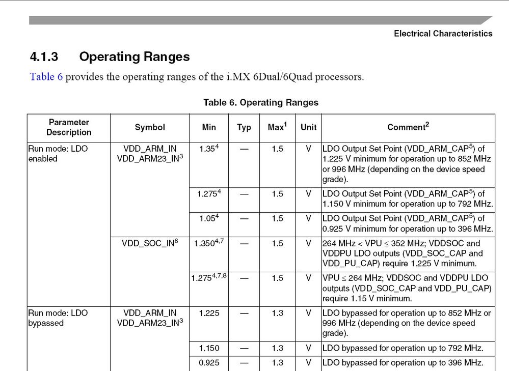

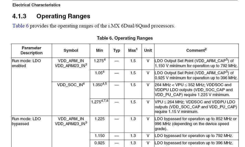

igorpadykov
Hi juvin
number of working points is defined in datasheet, one can not
add them arbitrary, for example IMX6DQCEC
3 points ldo mode
IMX6DQIEC   only 2 points ldo mode
