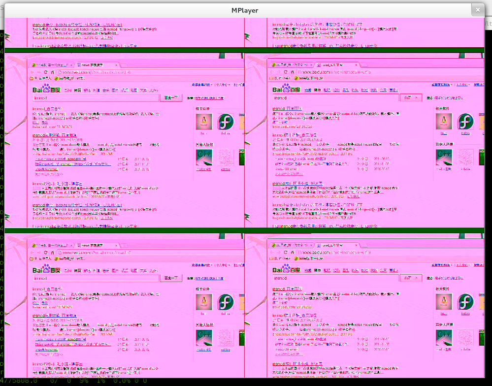

hi all:
we use imx6 ipu/csi (no mipi) to capture 16bits yuv data with external hsync/vsync,
( IOMUX = D19~D12=Y, D11~D4=U/V,  PCLK+HSYNC+VSYNC)
but the image like this:
we have set csi as gade mode to capture 16 bit generic data,
[INFO]    VPU test program built on Sep 12 2013 17:49:15
[INFO]    Product Info: i.MX6Q/D/S
[INFO]    VPU firmware version: 2.1.9_r36350
[INFO]    VPU library version: 5.4.12
[INFO]    Format: STD_AVC
[INFO]    AVC
[INFO]    Output file "hout.mkv" opened.
[INFO]    chromaInterleave 1, mapType 0, linear2TiledEnable 0
ioctl_g_fmt_cap, 0x10 status:0x6b
===IPU_PIX_FMT_GENERIC_16:844451913======ipu_csi_init_interface=======104====
CSI_SENS_CONF = 0x00000B01
CSI_SENS_FRM_SIZE = 0x02FF03FF
CSI_ACT_FRM_SIZE = 0x02FF03FF
    sensor chip is adv7180_decoder
[INFO]mxc_v4l2_s_param, type:0
    sensor frame size is 1024x768
===FMT:844451913======mxc_v4l2_s_param=======1401====
CSI_SENS_CONF = 0x0000CB01
===FMT:842094158===ch:0===_ipu_ch_param_init=======259====
===IPU_PIX_FMT_NV12======_ipu_ch_param_init=======447====
ch 0 word 0 - 00000000 60000000 00000000 E0000000 000BFC7F
ch 0 word 1 - 03340000 00668000 0087C000 0000FFC0 000003FF
PFS 0x4, BPP 0x0, NPB 0x1f, FW 1023, FH 767, scan_order 0
[WARN]    Ctrl-C received
[INFO]    Finished encoding: 136 frames
[INFO]    enc fps = 113.04
[INFO]    total fps= 29.78

Hi chunxin,
Unfortunately, current Freescale Linux BSP doesn't support 16-bit input through CSI (although the IC supports).
Rgds

chunxin
Hi ( IOMUX = D19D12=Y, D11D4=U/V, PCLKHSYNCVSYNC) is not for BT1120.
BT1120 mode, the 16bits CSI data lines should be CSI_D_19 ~ CSI_D_12, CSI_D9 ~ CSI_D_2).
You should check https://community.freescale.com/message/302798#302798
