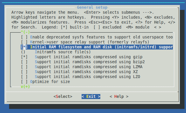

I am wondering if anyone has booted into a rootfs on a ramdisk.
What u-boot options did you use? How big was your rootfs?

This issue is due to the kernel config. I assume you're using the Freescale-supplied kernel, which doesn't have RAM disk support built-in:
     https://github.com/boundarydevices/linux-imx6/blob/boundary-L3.0.35_12.09.01_GA/arch/arm/configs/imx...
These couple of kernel config variables are needed:
  • CONFIG_BLK_DEV_INITRD=y
  • CONFIG_RD_GZIP=y
See this link for an example:
     linux-imx6/arch/arm/configs/imx6_defconfig at boundary-L3.0.35_12.09.01_GA · boundarydevices/linux-i...
You can also use 'menuconfig' to select it. Choose 'General Setup' on the first page:

FYI - I am using the following bootargs
   console=ttymxc1,115200 ip=dhcp root=/dev/ram0 rw
My ramdisk is ~24Meg - and I am downloading this ramdisk to 0x1100_0000, so my bootm:
   bootm 0x10800000 0x11000000
Can somebody help me?

You don't need the root=/dev/ram0 if you use the two-argument form of bootm.
The kernel will pick this up directly and this should boot.

Sorry - but I tried it without - but it is still crashing - same type of thing
a) Built  a minimalistic (initramfs) image in the Freescale 12-09 LTIB
    (initramfs.cpio.gz ~38MB, 139MB uncompressed).
b) mkimage (initramfs.cpio.gz)
c) use minimum bootargs:
   >> Kernel command line: console=ttymxc1,115200 video=mxcfb0:dev=hdmi,1920x1080M@60 ip=dhcp
d) used bootm 0x10800000 0x11000000
and I got this (looks like something VFS is looking for something to mount):
>> Kernel panic - not syncing: VFS: Unable to mount root fs on unknown-block(0,0)
What could I be doing wrong (it looks like from everything I can tell that this should work)?
  • CONFIG_RD_GZIP=y
7,631 Views
TomMorrison
