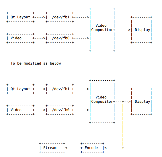

Hi All,
           One of our design (based on imx6 sabre lite board) demands to transfer qt buffer (buttons - overlayed) + video over rtsp (h264/mpeg encoding). So the path being displaybuffer (gstreamer+qt) -> vpu(encoding) -> rtsp. We are using yocto with qt x11. Which will be the best way to achieve this. Our gstreamer version is 0.10. Do we have any reference for this.
Faizel

Hi Faizel
This might be helpful for your case:
RTSP gstreamer and vpudec
regards

faizel
      Thank you . Actually, our case deals with streaming display buffer (video + menu buttons).  Please see the below figure for more clarity. The additional block in the second one is what we need to add. (Encode and stream after video compositor)
Pls comment.
Faizel

faizel
     Any body do have any comments or suggestions?
