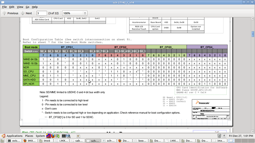

shanmugamsundar
hi Aven,
       The default sabrelite board uses the ECSPI-1 for the booting, but in our customized board we are using the  ECSPI-4 for booting, my doubt is whether we want to change the corresponding IO pin settings or is there any other special settings needed
Note:-
Plz check the below image and  tell me
The attached Schematic image is taken from IMX6qAICPU-1
can we use that Configuration for SPI -4 Sabrelite board
shan

aven_tsao
HI Shan:
Sorry for my mistake, I just try the boot mode switch on sarbelite board, and found the boot configure is controlled by efuse. That’s mean change the boot device on sarbelite board is not allow.
Please use md command (md.l 0x020d801c 1) under u-boot command mode to dump the SBMR2 to check the “BT_FUSE_SEL” bit on you board. If the bit [4] is “1”, it’s means the boot option is coontrolled by efuse. And you can’t change the boot device to SD card.
In the SABRE AI board, we use external IO pins for boot configure setting, so you can chsnge the boot device very easy.
Aven

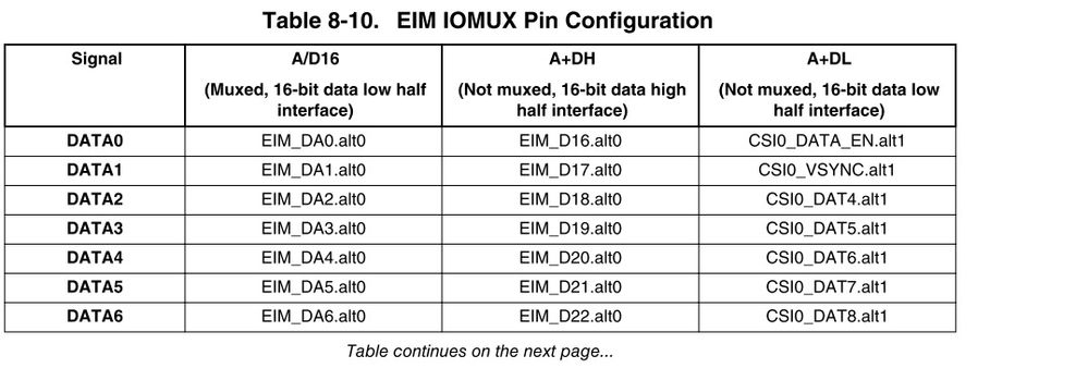

aven_tsao
Hi Praveeng:
I’m sorry to say the sabrelite board is not suitable for NOR flash boot from EIM bus.
The reason is some data pins didn’t connect out, so you can’t connect NOR Flash to EIM Bus.
Please reference to below table, the CSI0_DAT4~7 (A+DL mode) and EIM_D20, D24, D24, D29, D30 (A+DH mode) are not connect out on sabrelite board.EIM.jpg
Aven
