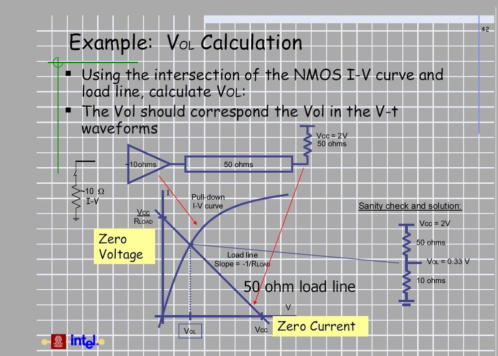

We provide several IMX6 GPIO pins to connectors for off-board use and are continually asked what drive strength these pins can support.  The IMX6DQRM documents the DSE field of the various iomuxc pad control registers as impedance values (HIZ, 240ohm, 120ohm, 80ohm, 60ohm, 48ohm, 40ohm, 34ohm for the pads we use).  In our configuration the pads we use are on 3.3V rails.  We have been told that in order to provide an output voltage vs current chart for the IO cells for our customers we need to use the IBIS models for the IMX6 IO cells.    Has anyone done this or can anyone shed some light on the subject of what 'output' voltage vs current is possible at the various DSE's?

3.
As for volt ampere curves, when considering current using IBIS it is needed to take into account external
resistive load R. The current I may be defined as solution of equation :
Vol = OVDD – I * R
  (at cross point of IBIS Volt-Ampere curve and straight line I = (OVDD – Vol) / R)
Please take a look at the figure.
Please use typical I(typ) of IBIS volt-ampere curves.

Thanks for the info.  I'm aware of the standard 'Zo = (VCC – VIOH) / Iout' equation but this assumes you have a constant VIOH.  Customers want to know what Ioh and Iol are at various voltages.  The IMX6DQIEC Table 22 only shows Ioh and Iol for OVDD-0.15 and 0.15 respectively.  Furthermore, Table 22 seems to indicate that there are really only two categories of drive strength (DSE 001, 010 vs DSE 011,100,101,110,111) which makes me even more confused at what DSE really does.  What we are interested in is a Voltage/Current graph which you wouldn't need to know anything about the load being drive for (because the load there would simply be V/I).
We have not encountered datasheets with I/O cells requiring you to use IBIS models for simple V/I curves and quite frankly I don't have the software/knowledge to run a simulation on an IBIS model.  Does this really need to be that complicated?  Perhaps the datasheet can provide some additional current conditions such as Ioh @ VDD - 0.8V and Voh @ 0.8V
