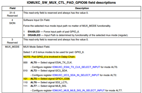

art
Please refer to the IOMUXC_SW_MUX_CTL_PAD_GPIO06 register field descriptions table on the Page 2068 of the i.MX6Dual/Quad Reference Manual Rev.5 document, available on the processor's Documentation web page:
https://www.nxp.com/products/processors-and-microcontrollers/applications-processors/i.mx-applicatio...
The Table says that the pad is involved in a number of daisy chains. So, please check the configuration of all related IOMUXC registers, mentioned in the Table.

art
The wrong configuration of other pads, involved in daisy chain, can affect the GPIO06 pad operation as well. So, anyway, please check the configuration of other pads, involved in this daisy chain.
