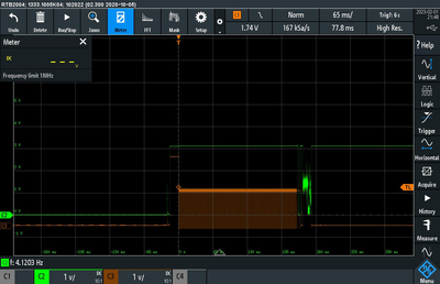

It looks like the imx6 reads first data including DCD and execute it. Then it load usb-downloader-mode.
green - CMD
brown - CLK

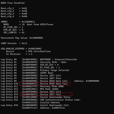

Then we tested the device with boot_tester.exe
We have got the data:
Can any one tell me what does the Device Init Fail  means?

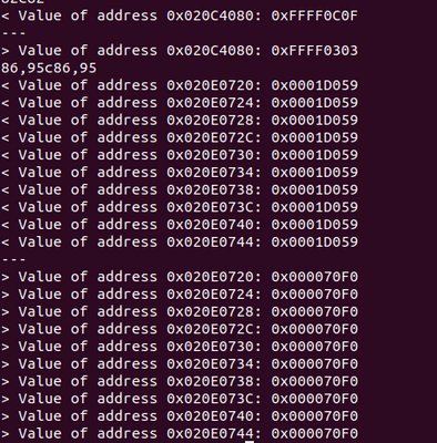

Tried to read different registers with uuu. And found that some registers has not default values and not at the state I have set at DCD.
For example:
I set at DCD gpio  for SD4 at value  0x0001D020,but in time when the device fall to USB I have 0x000070F0. It is not a default value (0x0001B0B0).
You can see diff of two registers (bmode usb VS freeze)

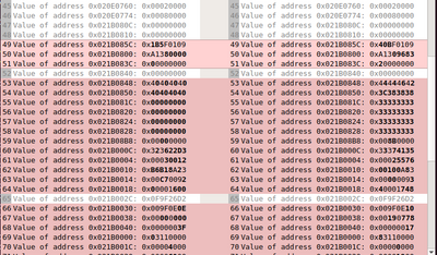

And it is not only with iomuxc problem.  Some times I see problems even with mmdc initialization. For example:
Above you can see registers after two different freezes. At the left side mmdc registers even are not set (I haven't compared with default).At the right side another freeze but mmdc registers are set almost properly. Look at the register 0x021b08b8 must be 0x00000800. But there none of them contain this value.
OSC looks  stable.
Powers - also stable. I reproduce the freezes even in cycle reset.
Just set at u-boot param bootcmd as reset

Yes. Sorry I haven't mentioned that my emmc on uSDHC4
=> You are correct, In that case, it is obvious that init will fail.

ivan_113
MFG Mode USDHC device Init Fail looks like it's absent
2,545 Views
Kanstantsin1
Yes. Sorry I haven't mentioned that my emmc on uSDHC4.

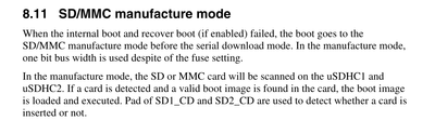

There are another devices on  uSDHC1 and uSDHC2 on the custom device. So MFG uSDCH INIT will not be passed anyway.
Here is  written about uSDHC1 and uSDHC2:
